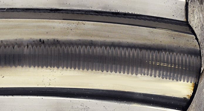

Q: I’ve done work in a hospital where every pump motor was on an ABB drive. They had a massive bearing fluting problem. Could this be an ABB problem, or just a typical overcrowded hospital mechanical room with inadequate grounding?
A: The problem is definitely NOT specific to ABB, or any other manufacturer. Fluting happens to motors on all brands of drive. We don’t know of any exact statistics, but we estimate that something like 50% of all unprotected motors on drives will get it.
Whether electrical bearing damage happens or not is partly random. But there are known contributing factors. Having a poor frame-to-ground connection can definitely make it worse.
As for the room’s ground, a mechanical room should have less than 5 ohms resistance. You should definitely test the ground quality, or have a contractor do it, because if the resistance to ground is too high, then AEGIS rings won’t work. If you had 50 ohms, say, between the room and the building ground, that’s not good.
The next step would be to check the individual motors’ grounds. If those have high resistance, you might try a high frequency grounding strap. Common mode chokes or cores can also help.

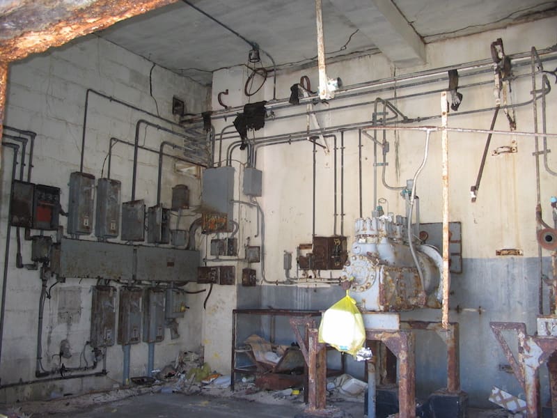

Q: I’ve found that fluting is more prevalent in motors in older facilities, as opposed to new construction. Retrofitting may overwhelm existing grounds. Do you have any evidence or experience with this?
A: There’s not 100% correlation here, but if you have a 30 year old building & you install drives, you’re going to use what’s already there. Old, degraded grounds will have higher resistance and make stray currents more likely. Contrast this with a new building, where drives are specified up front. In new construction, the grounding & other systems will be specified to be able to stand up to drive power.

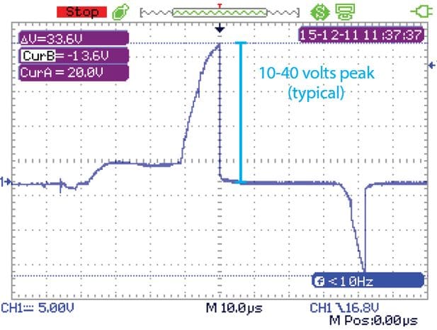

Chokes reduce rotor ground currents in poorly grounded motors, and high frequency circulating currents in large motors (100 hp/75 kW plus). But they DON’T reduce capacitive shaft voltage, so you still get arcing through the bearings. We’ve got videos of this. The videos show a motor with common mode chokes, and you can see the shaft voltage slowly rise and then suddenly drop, which means that it’s arcing through the bearing. That’s going to cause damage. You don’t see this buildup and discharge with AEGIS rings. AEGIS keeps the shaft voltage too low to arc through the bearing.
As for rotor ground and circulating currents, chokes probably do at least reduce damage. There are unbiased experts who recommend them for these types of bearing current. Some of their manufacturers’ and distributors’ claims are questionable, though, and we should point out that chokes do not come with a warranty against bearing damage.
