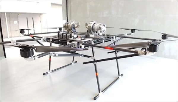

The new product was used for the gas turbine generator of a large drone (high payload emergency supply delivery drone equipped with a gas turbine generator) equipped with an 80-kw hybrid drive system for a regional reconstruction and practical development promotion project in fiscal 2023, and delivered to Fukushima Prefecture on February 21, 2024.

                                            High Payload Emergency Supply Delivery Drone
                                                  Equipped with a Gas Turbine Generator
                                           (Photo courtesy: Aero Development Japan, Inc.)

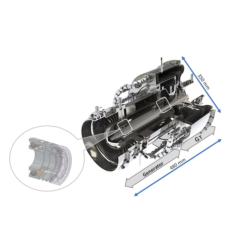

Bearing Positioning in Gas Turbine Generator (Photo courtesy: Aero Development Japan, Inc.)

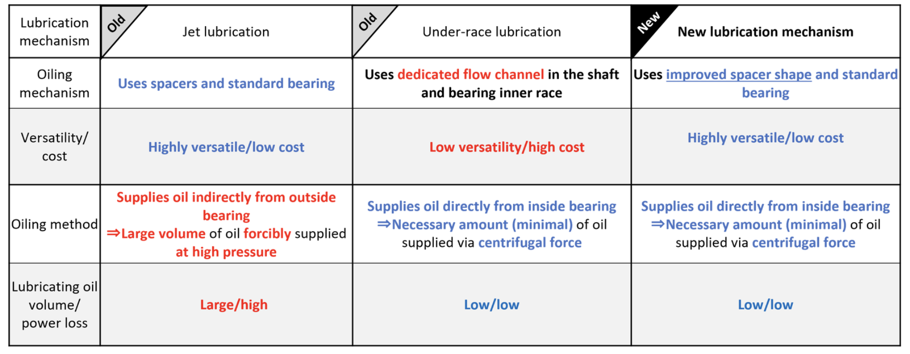

The problem with jet lubrication, a common lubrication mechanism used for high-speed bearings, is that it requires a large amount of lubricating oil and causes high power loss. NSK’s new product resolves this issue by incorporating under-race lubrication as used in higher revolution applications, delivering reduced power loss and lubricating oil volume.
2) Issues with the conventional lubrication mechanism

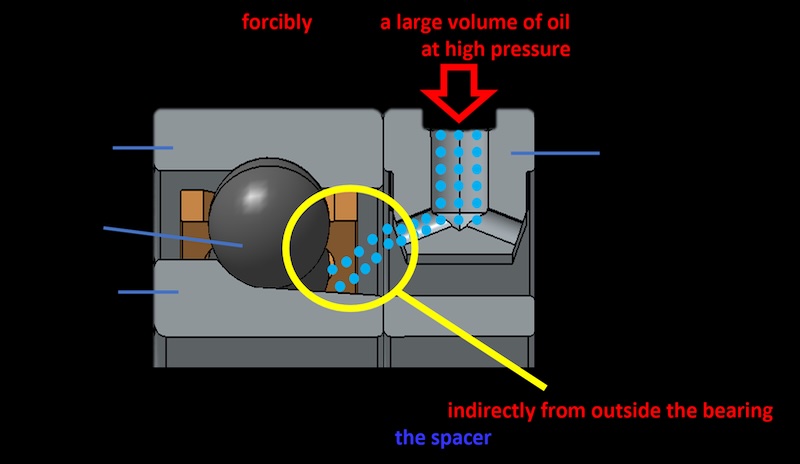

Jet lubrication uses highly compatible parts, spacers, in the oiling mechanism, making it versatile and cost-effective, but a large volume of oil is forcibly supplied at high pressure from outside the bearing, resulting in large volume lubricating oil usage and significant power loss.
New Product Structure

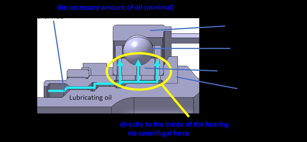

On the other hand, under-race lubrication uses dedicated flow channels in the shaft and bearing inner race to directly supply oil, a method which has low versatility and high cost. The benefit is that, since only the necessary amount of oil (minimal) is supplied via centrifugal force, this method is offers minimal power loss and oil usage.
3) New lubrication mechanism
NSK’ new lubrication mechanism features an improved spacer shape allowing for direct supply of the necessary amount of oil (minimal) to the inside of the bearing using centrifugal force. This solution reduces the amount of lubricating oil and power loss, yielding a new highly versatile, low-cost lubrication mechanism.
