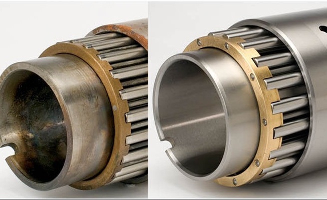

ScheererBearingRebuildBEFOREandAFTER2
Bearing Rebuilding vs. Replacement: The Advantage is Obvious
Scheerer Bearing can typically rebuild a large bearing and deliver it to you in a fraction of the time required to manufacture a new bearing. We also provide emergency repair service – sometimes within a 24-hour period.
Rebuilding can save up to 60% of the cost of a new bearing. Keeping an eye on the bottom-line is good business, and we find that customers with large bearing investments are looking to us to help them maximize the service lifetime of their bearings and their heavy machinery. A scheduled reconditioning of critical bearing components ensures business operations stay on schedule at maximum output.
