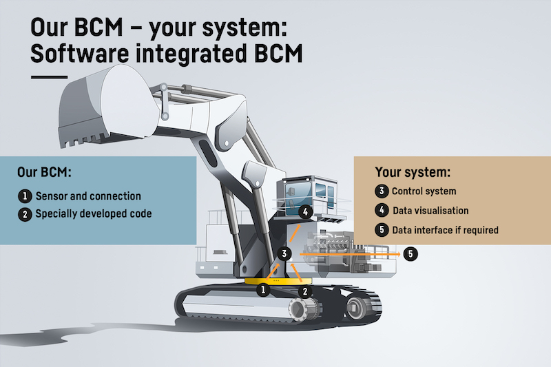

Digital wear monitoring for slewing bearings
Bearing clearance monitoring (BCM) provides a digital solution for measuring wear in slewing bearings. Built-in sensors allow precise measurements of axial and radial wear without requiring technicians to perform manual checks in hard-to-reach areas. This does not only improve safety, but also speeds up the monitoring process. Permanently installed sensors enable quick wear measurement via a web app, which can reduce downtime by up to 75%.
An upgrade to the BCM can be seamlessly integrated in the customers’ system without the need for additional measuring devices or gateways, reducing system complexity and allowing users to analyse measurement data within your own systems.

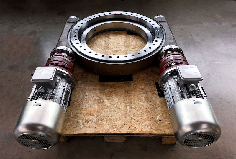

Electrifying slew drives: efficient and environmentally friendly
Our slew drives can be powered electrically, offering clear advantages: They reduce noise emissions and do not require hydraulic oil, which prevents the risk of oil leaks. Electrically driven slew drives are ideal for applications, where no hydraulic systems are used. They offer a clean solution, especially in sensitive environments. The electric motors are also highly adaptable and can be combined with various gears. Thanks to intermediate flanges, motors can be easily integrated and installed in a space-saving manner. Electrically powered slew drives excel in precise positioning tasks, as their power control allows for accurate movements.

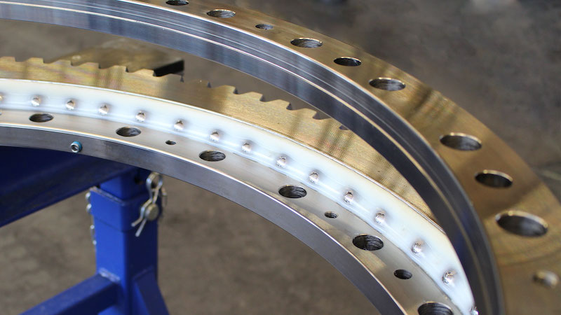

Lifinity solid lubrication: maintenance-free slewing bearings
Liebherr’s innovative solid lubrication, Lifinity, eliminates the need for regular relubrication. In this process, a heated polymer-oil mixture is introduced into the heated bearing. As it cools, it forms a stable layer that provides long-term lubrication for the bearing. A major advantage is the significant reduction in maintenance, as regular relubrication is no longer necessary, leading to considerable savings in operating costs and time. This increases productivity, as equipment requires less downtime for maintenance, thus extending the lifespan of machines and boosting overall operational efficiency. Lifinity also reduces the risk of corrosion, enhancing the longevity of the bearing.
Additionally, Lifinity is environmentally friendly: Conventional greases and oils can leak and pollute the environment, but with Lifinity, there’s no such risk. This technology also meets strict NSF/H1 standards, making it suitable for food-related environments.
